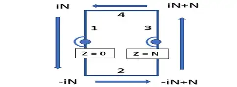

We can also use complex integration to find full asymptotics at $x\to0$.
Let's denote $$S(\phi)=\sum_{n=1}^{\infty}\frac{(-1)^{n-1}}{n}\frac{\sin^{2}(nx)}{(nx)^{2}}\sin^{2}(n\phi)$$ and consider the integral in the complex plane along the following rectangular contour $C$, where $N=1, 2, 3...\to\infty\,$ and $\,2(x+\phi)\leqslant \pi\quad\tag{a}$
$$I=-\frac1{2\pi i}\oint_C\frac\pi{\sin\pi z}\frac{\sin^2(zx)\sin^2(z\phi)}{x^2z^3}dz=-\underset{z=0,1,2,...}{\operatorname{Res}}\frac\pi{\sin\pi z}\frac{\sin^2(zx)\sin^2(z\phi)}{x^2z^3}=S(\phi)$$ On the other hand, it is starightforward to see the the integrals along the path $2,\,3,\,4$ tend to zero at $N\to\infty$ (if the condition (a) above is met). It means that $$S(\phi)=-\frac1{2\pi i}\int_{\infty}^{-\infty}\frac\pi{\sin(\pi i t)}\frac{\sin^2(itx)\sin^2(it\phi)}{x^2(it)^3}idt$$ $$=\frac1{8x^2}\int_{-\infty}^\infty\frac{\left(\cosh(2tx)-1\right)\left(\cosh(2t\phi)-1\right)}{t^3\sinh(\pi t)}dt$$ Decomposing $\cosh(2tx)-1$ near $x=0$ (i.e. dropping exponentially small terms) $$S(\phi)\sim\frac14\int_{-\infty}^\infty\frac{\cosh(2t\phi)-1}{t\sinh(\pi t)}dt+\sum_{k=2}^\infty\frac{4^{k-1}x^{2k-2}}{2(2k)!}\int_{-\infty}^\infty\frac{\cosh(2t\phi)-1}{\sinh(\pi t)}t^{2k-3}dt$$ I leave to those who are interested to show that $$\frac14\int_{-\infty}^\infty\frac{\cosh(2t\phi)-1}{t\sinh(\pi t)}dt=\frac12\int_{-\infty}^\infty\frac{\sinh^2(t\phi)}{t\sinh(\pi t)}dt=-\frac12\ln(\cos\phi)$$ (see, for example, here or here )
Using also for odd $n$ $$J(n)=\int_{-\infty}^\infty\frac{\cosh(2t\phi)-1}{\sinh(\pi t)}t^ndt$$ $$=\frac1{2^n}\frac{\partial^n}{\partial\phi^n}\int_{-\infty}^\infty\frac{e^{2t\phi}}{\sinh(\pi t)}dt-\frac1{2^n}\frac{\partial^n}{\partial\phi^n}\bigg|_{\phi=0}\int_{-\infty}^\infty\frac{e^{2t\phi}}{\sinh(\pi t)}dt$$ and the value of the integral (the proof, for example, by means of complex integration is straightforward) $$\int_{-\infty}^\infty\frac{e^{2t\phi}}{\sinh(\pi t)}dt=\tan\phi$$ after some transformations we get the answer $$S(\phi)\sim-\frac12\ln(\cos\phi)+\sum_{k=2}^\infty\frac{\tan^{(2k-3)}(\phi)-\tan^{(2k-3)}(0)}{(2k)!}x^{2k-2}$$ $$=-\frac12\ln(\cos\phi)+\left(\frac1{\cos^2\phi}-1\right)\frac{x^2}{4!}+\frac{6-4\cos^2\phi-2\cos^4\phi}{\cos^4\phi}\,\frac{x^4}{6!}+O\big(x^6\big)$$ Numeric check (WA) confirms the answer.
