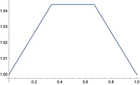

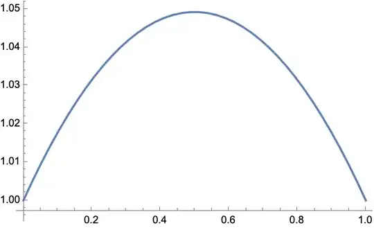

Below you can find the numerical solution using 4 grid nodes and 40 grid nodes. All the constants were set to 1 and, just out of laziness, I've set the last equation to $y_n=1$, instead of changing to backward differences.

If we put $y = \xi^2$ then Equation 1 becomes $$2y\ddot{y} - \dot{y}^2 = 4A.\tag{3}$$ Taking the derivative of this equation we obtain $$2y\cdot \dddot{y} = 0$$ for which $y = Bx^2+Cx+D$ follows. Inserting this back into Equation 3 we get the constraint $D = \frac{4A + C^2}{4B}$ and the general solution is therefore $$y = B\left(x+\frac{C}{2B}\right)^2 + \frac{A}{B}.$$ Next imposing $y(0) = y(1)$ we get $C = -B$ and $$\xi(u) = \pm\sqrt{\frac{A}{s} + s(u-1/2)^2},$$ where $s$ ($B$ above) is a free constant (determined by the initial condition $\xi(0)^2 = \frac{A}{s} + \frac{s}{4}$). Note that the solution shown in Pierre's answer corresponds to taking $A \simeq -0.44$ and $s\simeq -0.40$.
