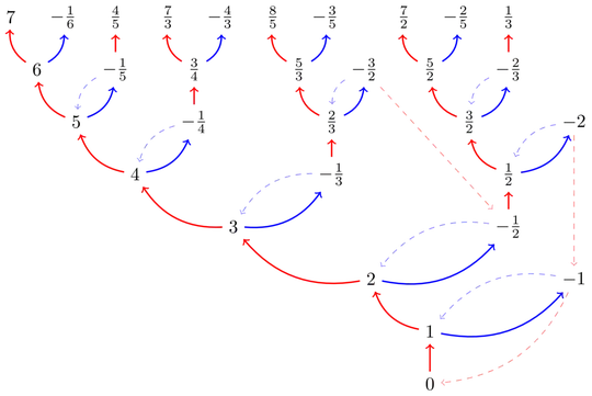

A tree and a table of $X_n$.
Here's an illustration of the growth process.
Tree showing growth of X_n
Here are the numbers in a table: $$ \begin{array}{c|l|c} n & X_n & |X_n| \\ \hline n=0 & \{0\} & 1 \\ n=1 & \{1\} & 1 \\ n=2 & \{-1, 2\} & 2 \\ n=3 & \{-\frac12, 3\} & 2 \\ n=4 & \{-\frac13,\frac12,4\} & 3 \\ n=5 & \{-2,-\frac14,\frac23,\frac32, 5\} & 5 \\ n=6 & \{-\frac32,-\frac23,-\frac15,\frac34, \frac53, \frac52, 6\} & 7 \\ n=7 & \{-\frac43,-\frac35,-\frac25,-\frac16,\frac13,\frac45,\frac74,\frac83,\frac72,7\} & 10 \end{array} $$
