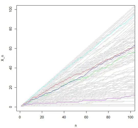

and the initial parts of some simulated paths
simulated paths
