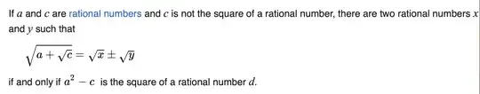

It says on the wikipedia page that...
I am confused as to why a nested Radical of Depth 1 can only be de-nested if $a^2-c$ is the square of a rational number. Here is my below attempt to reason out why...
Suppose you had the quadratic $x^2-ax+\frac{c}{4}$. Then, by the quadratic formula, the roots are $x = \frac{a+\sqrt{a^2-c}}{2}$ and $x = \frac{a-\sqrt{a^2-c}}{2}$. Let the first root written here be $d$ and the latter root be $e$. Hence, by the product and sum relationships of a polynomial with degree 2 (and also just by algebra)
$$d + e = a $$ $$de = \frac{c}{4}$$
but $$\sqrt{d}+\sqrt{e} = d + 2\sqrt{de} + e$$
Hence
$$\sqrt{d}+\sqrt{e} = \sqrt{a + \sqrt{c}}$$
Now, what I observe is that if $a^2 - c$ is a rational square, then the roots d and e will become rational.
What am I missing?
