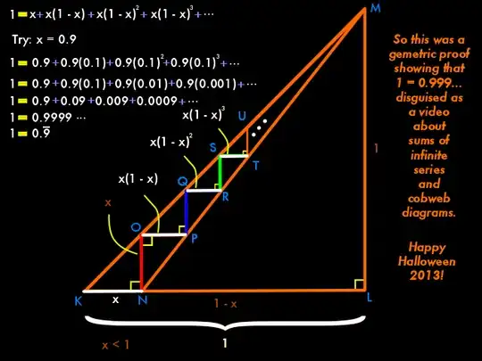

It is an integer and the integer is 1. I recently made a Halloween video on cobweb diagrams with a visual proof of this result (which is meant to be a surprise, but I'm spoiling it, sorry). With the cobweb diagram and a knowledge of geometry, you can visualize why 1 is the infinite sum. The two notations 1 and 0.9999... represent the exact same length, the integer 1. The proof is my own which was modified from a visual proof on infinite series (see part 1 of the videos).
Here is video of my proof explained: http://www.youtube.com/watch?v=MhaRGt9rmyo
And if I'm lucky this one image will convey the whole proof (The length of the bottom of the triangle is 1 which is the same as the sum of all the white horizontal lengths, reaching up to infinity at point M, 0.9 + 0.09 + 0.009 + ...). Obviously x is not drawn to scale with 1, but this is done to show the "cobweb" better. The video walks through the geometric proof.
