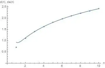

We have to find the asymptotic behaviour for $n \to \infty$ of the sum
$$s(n) = \sum _{i=1}^{n } \frac{1}{\sqrt{i (i+1)}}$$
Let us adopt a more symmetric approximation to the summand and consider the quantity
$$ds(n):=\sum _{i=1}^{n } \left(\frac{1}{\sqrt{i (i+1)}}-\frac{1}{2} \left(\frac{1}{i}+\frac{1}{i+1}\right)\right)$$
This can be written as
$$ds(n)=s(n) -\frac{1}{2} \left(\left(H_{n+1}-1\right)+H_n\right)$$
where $H_n$ is the harmonic number.
From the asymptotic behaviour of $H(n)$ we obtain
$$s(n) \simeq s_a(n) = c-\frac{1}{2}+\gamma+\frac{1}{n} +\log (n)-\frac{7}{12 n^2}+ \frac{1}{2 n^3} $$
where the constant $c$ is given by
$$c = ds(\infty) \simeq -0.0581871$$
The plot of $s(n)$ and $s_a(n)$ shows surprisingly good aggreement even down to $n=2$
