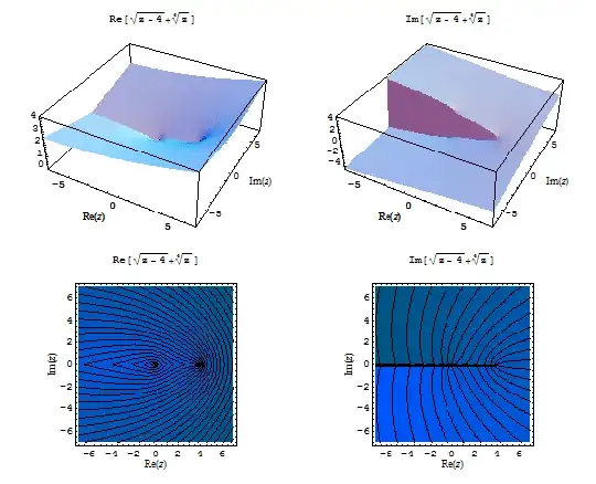

As a way of visualizing the Riemann surface of $\sqrt{z-4} + \sqrt[4]z$, let's look at the real and imaginary components:
The branch points $z=0$ and $z=$ are noticeable in the plots of the real part, while the cuts can be seen in the plots of the imaginary part.
- 76,540
I did this with an old version of Mathematica; maybe somebody with
$VersionNumber > 5could make a better version of these pictures. Feel free to edit if you've better pics... – J. M. ain't a mathematician Jul 16 '11 at 08:32
