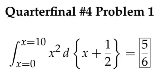

How to evaluate the integral $$\int_{x=0}^{x=10}x^{2}d\left\{x+\frac{1}{2}\right\}$$
This is one another integral which I am having doubt. This integral is also from MIT Quarterfinals $2025$.
My Thoughts :
First of all it took me $2$ days to think for this integral.
But still I thought of only $4$ steps.
Let me explain my thoughts.
I assumed the given integral as $I$. That is I got
$$I=\int_{x=0}^{x=10}x^{2}d\left\{x+\frac{1}{2}\right\}$$
Now I wrote this given integral in the form of
$$I=\int_{x=0}^{x=10}x^{2}dx×\frac{d}{dx}\left(\left\{x+\frac{1}{2}\right\}\right)$$
I really don't know whether this step is correct or wrong.
Now the next step is that I wrote $$\left\{x+\frac{1}{2}\right\}$$ as $$\left(x+\frac{1}{2}\right)-\lfloor{x+\frac{1}{2}\rfloor}$$
Now we can easily say that
$\frac{d}{dx}\left(\left\{x+\frac{1}{2}\right\}\right)=\frac{d}{dx}\left((x+\frac{1}{2})-\lfloor{x+\frac{1}{2}\rfloor}\right)$
Now it is very clear to me that $$\frac{d}{dx}\left(\left\{x+\frac{1}{2}\right\}\right)=1$$ because $\lfloor{x+\frac{1}{2}\rfloor}$ is a constant and its derivative with respect to $x$ will result in $0$.
Therefore finally the integral is turning out as $$\int_{x=0}^{x=10}x^{2}dx$$ which yields the answer to be $\frac{1000}{3}$
But the correct answer mentioned is $\frac{5}{6}$.
Please rectify my mistake.

This integral must be interpreted as a Riemann-Stieltjes integral. Toward that end, note that $\{x+\frac12\}$ is a function which is differentiable with derivative $1$ whenever $x +\frac12 \not\in \mathbb{Z}$, and at the points where $x+\frac12\in\mathbb{Z}$, it has a jump of $-1$.
Together, this means $$\begin{align*} \int_0^{10} x^2\,\mathrm{d}\{x+\frac12\} &= \int_0^{10} x^2 \,\mathrm{d}x - \sum_{0 < x < 10 \\ x+\frac12 \in \mathbb{Z}}x^2 \\ &= \frac{1000}{3} - \sum_{n=0}^9(n+\frac12)^2 \\ &= \frac56 \end{align*}$$
