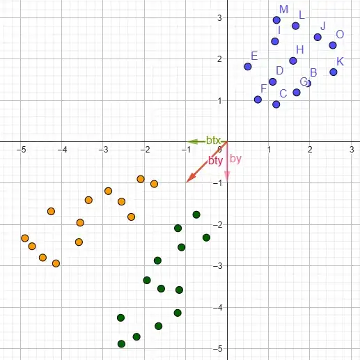

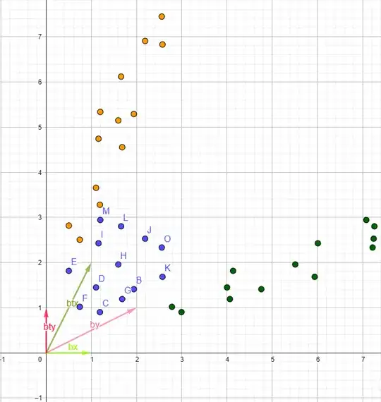

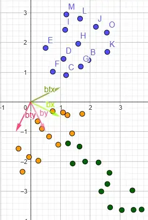

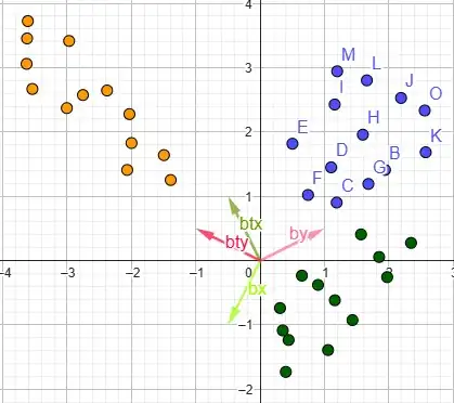

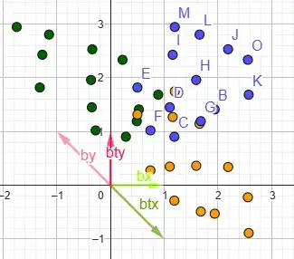

    1. Why does $A^T$ simply mirror the basis vectors along $y=x$ in the 1st & 3rd quadrant, while in the 2nd & 4th quadrant it seems to get stretched in the opposite direction of $A$ along $y=-x$? See images below
Regarding the images - from top to bottom they use these matrices:
$A_1 = \begin{bmatrix} 1 & 2 \\ 0 & 1 \end{bmatrix}$ $A_2 = \begin{bmatrix} -1 & -1 \\ 0 & -1 \end{bmatrix}$ $A_3 = \begin{bmatrix} -0.5 & 1 \\ -1 & 0.5 \end{bmatrix}$ $A_4 = \begin{bmatrix} 1 & -0.5 \\ 0.5 & -1 \end{bmatrix}$ $A_5 = \begin{bmatrix} 1 & -1 \\ 0 & 1 \end{bmatrix}$
Additionally there are the basis vectors $\underline b_x$ & $\underline b_y$ of the $A$ matrix and the basis vectors of the transpose $\underline b_{tx}$ & $\underline b_{ty}$ of the $A^T$ matrix. The green dots are the fixed blue dots transformed by $A$, while the yellow dots are the fixed blue dots transformed by $A^T$.
Image 1 Image 2 Image 3 Image 4 Image 5
