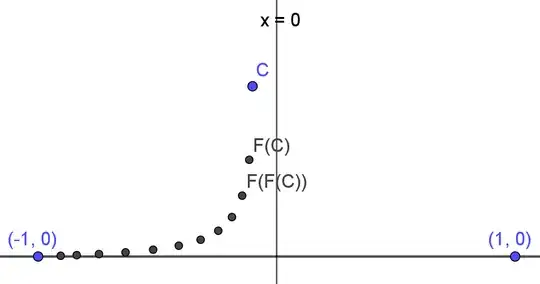

The symmedian point of the triangle with vertices $A=(-1,0),B=(1,0),C=(x,y)$ is $$F(x,y)=\left(\frac{4 x}{x^2+y^2+3},\frac{2 y}{x^2+y^2+3}\right)$$ By this question $F$ maps $\mathbb{R}^2$ onto an ellipse with foci $A,B$ and eccentricity $\frac{\sqrt3}2$.
Consider the iterated symmedian points $F^2(x,y)=F(F(x,y))$, $F^3(x,y)=F(F(F(x,y)))$, etc.
From the plot, it appears that the iterated symmedian points converge to $(-1,0)$ when starting from left half plane. My attempt to prove this: from the formula, $\frac yx$ gets multiplied by $\frac12$ in each iteration, so the angle $\frac yx$ approaches $0$, so the sequence converge to a point on $x$ axis.
The iterated symmedian points appear to lie on a curve.
What is this curve? Is it an algebraic curve?
