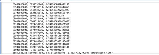

    I hadn't timed my unoptimized Julia code before but out of curiosity, I ran it for $10$ billion simulations on my Macbook M3 to compare against your runtime. My code is not optimized or parallelized and basically runs end to end on a single thread. Even though I did not change the random number generator every $30$ simulations, it still rand $10$ simulations in just $26$ mins. Julia is crazy fast !!! t. I think when properly parallelized Julia could run even faster. Sharing my code below as an answer. – Nilotpal Sinha Jan 01 '25 at 13:24
    Just one small note: the "making a new random" is not doing what you think it does. You do not make it "more random" and avoid any bias simply by reseeding the RNG (which is effectively what this does). If the RNG did have some bias then you would need a completely different algorithm (e.g. math.random), not a new instance of the same algorithm with a different seed. – Winther Jan 04 '25 at 11:54
Not an answer but sharing my unoptimized and unparallelized Julia code runs $10$ billion simulations in just $26$ mins on a Macbook M3 Pro. Julia is crazy fast !!! t. If properly parallelized Julia could run even faster.

    There is no need to draw 3 random points. You can take advantage of the symmetry of the problem and just fix the first point to, say, $(0,1)$ (i.e. we simply align one axis of the coordinate system we use to point along the first point drawn). This reduces the random numbers you have to generate by 33%. – Winther Jan 03 '25 at 18:04
  • @Winther Thats true, I have that in the optimized version. The overall gain however is barely $3%$ in Julia since very little time is spend on the random number generation compared to computing sine, cosines and distance. – Nilotpal Sinha Jan 03 '25 at 19:09
    Ok I see. If you needed to make it faster then using a fully compiled language with a good and fast RNG (e.g. Mersenne twister or PCG or similar) you could probably speed it up with a factor 3-4 + another factor of 3-4 with threads and get something like ~10 billion evaluations per minute. But anyway, its more than fast enough already for the purposes of just ruling out 0.75 as the true answer. – Winther Jan 04 '25 at 12:02
