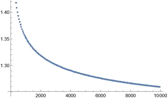

The Mathematica code below should calculate the desired function correctly:
Seq = {};
For[n = 10, n <= 10000, n = n + 50,
  temp = 1 + 1/n;
For[i = 1, i <= n, i++, temp = Power[N[temp, 20], N[temp, 20]]; ];
AppendTo[Seq, {n, temp}]; ]; ListPlot[Seq]
which gives $f(n,n)$ w.r.t. $n$: f(n,n) w.r.t. n
And hence I highly suspect that it converges. Taking $g(a,b)=\ln f(a,b)$ just gives $g(a,b)=g(a-1,b)\exp g(a-1,b)$ which does not quite simplify the structure.

    by trial an error I tried $f(x)=10.4/\ln(x)$ and kind a suits (I look for $a/\ln(3000) = 1.3\Rightarrow a\approx 10.4$ from the points in the graph)... Did you tried it? – Joako Dec 28 '24 at 19:30

    Quite surprizing $f(x) \sim 1+\frac{1+\sqrt{2}}{\log (x)}$ – Claude Leibovici Jan 01 '25 at 08:00
  • $f(n,n)$ is decreasing since $1+\frac{1}{n}<\left(1+\frac{1}{n}\right)^{1+\frac{1}{n}}<1+\frac{1}{n-1}$. If you can find a sufficiently sharp upper bound (this bound is too loose) on $x^x$ that's easier to work with, you might be able to show that $f(n,n)$ is upper-bounded by a function going to $1$. – Varun Vejalla Jan 02 '25 at 02:11
  • @ClaudeLeibovici How did you get that asymptotic? –  Jan 02 '25 at 12:58
  • @AkshajMishra. It is not an asymptotic but just a guess after a quick and dirty linear regression. Happy New Year ! – Claude Leibovici Jan 02 '25 at 13:02
