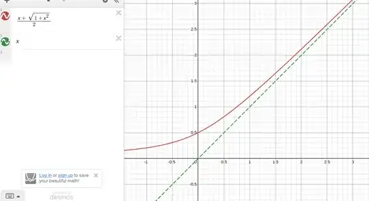

The wording is not precise, and I am worried that you may not understand the issues. In particular, in the case $a=-\infty$ and $b= \infty,$ there is no (finite) fixpoint for the example
$$ f(x) = \frac{x + \sqrt{1 + x^2}}{2} $$
Note that we always have $f(x) > x$ as well as $0 < f'(x) < 1.$
