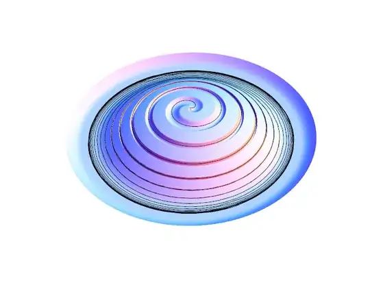

I have no trouble proving that the flow converges in the Morse case, but I've had trouble finding an example of a function and an initial point for which the flow does not converge. In such a case the flow would necessarily be asymptotic to some subset of the critical set of $f$, just not necessarily to a single critical point. I discussed this with someone a while ago and was told that the flow would always converge in the real-analytic category, so any local examples would be given by non-analytic $f$. It was suggested to me that a function whose graph over a flat subset looked like an infinitely long "groove" cut out of a bump (something like enter image description here with the edges of the groove smoothed out) would do the job (with the flow proceeding down the groove forever); but upon further thought it seems such a function would fail to be differentiable at the accumulation circle. (Edit: in retrospect, I think this idea does work - if the depth of the groove decayed fast enough, such a function can be differentiable, just not analytic.)

  • @Evgeny: thanks, I'll look in to Morse-Bott functions. I think my description of the groove example was lacking - I've updated with a more accurate plot, hopefully it shows what I'm trying to describe. – Anthony Carapetis Sep 23 '13 at 04:47
  • I think your "groove" example is fairly universal -- if any counter-example exists it would have to be more or less of that type. Have you ever heard someone claim there are counter-examples? Maybe there aren't. – Ryan Budney Sep 26 '13 at 19:28

  • Absil, Mahony and Andrews (2005) give an explicit expression for a $C^\infty$ function on $\mathbb{R}^2$ much like the one in your picture, stating that it indeed admits trajectories that wind around the unit circle for ever. That function is closely related to the one in the accepted answer. See eq. (2.8) in https://epubs.siam.org/doi/10.1137/040605266. There is also a discussion of why this cannot happen for analytic functions. – Nicolas Boumal Aug 10 '22 at 10:10
