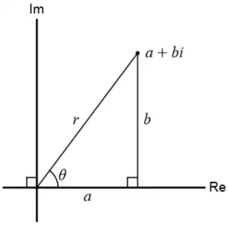

Here is my attempt at such a proof, but I'm not sure if my proof is free of circular reasoning (does it assume the Pythagorean theorem somewhere?).
For every complex number $a+bi$, where $a,b\in\mathbb{R}$, there is associated with it a (possibly degenerate) right triangle with hypotenuse $r$ and angle $\theta$, as shown in the following Argand diagram, in which the axes are perpendicular.
$\begin{align} a^2+b^2&=(a+bi)(a-bi)\\ &=r(\cos\theta+i\sin\theta)r(\cos(-\theta)+i\sin(-\theta))\\ &=re^{\theta i}re^{-\theta i}\\ &=r^2\\ \end{align}$

  • How do you define the unit circle, in your first bullet point? – FShrike Dec 10 '24 at 22:33
  • @FShrike The unit circle can be defined as the set of points in the plane that are one unit distance from the origin. – Dan Dec 10 '24 at 22:47
  • But how are you defining your metric? This is key. – FShrike Dec 10 '24 at 22:55
  • So, given complex numbers $(a,b)$, we must define their distance from the origin in such a way as to make the statement of Pythagoras' theorem actually interesting and obviously connected with "real geometric length". I believe this cannot be done; I certainly have never seen it done – FShrike Dec 10 '24 at 23:04
  • This is my major objection with attempts at proving Pythagoras. Either your metric is already defined so that Pythagoras' theorem is correct (by default) or your challenge is to relate some Euclidean primitive notions of length with some metric function $d:\Bbb R^2\times\Bbb R^2\to\Bbb R$ – FShrike Dec 10 '24 at 23:05
  • @FShrike Can we define the distance between two points in the complex plane (i.e. the origin and the point associated with $a+bi$) by just taking a ruler and measuring the distance? I don't mean to be facetious or anything like that; I suspect that I may be failling to grasp some subtlety. – Dan Dec 10 '24 at 23:15
  • I philosophically object to that. I certainly mathematically object to it, since you have not defined your ruler. But really, I see Pythagoras' theorem in the complex plane as definitionally true. The human-arbitrary choice of drawing Argand diagrams with orthogonal real and imaginary axes and the human-arbitrary choice of Euclidean metric just happens to very nicely marry the algebra of complex numbers with nice geometric ideas, so it is a successful choice that we have made, but it is a choice that is not forced. – FShrike Dec 10 '24 at 23:55
  • Because Pythagoras' theorem has strong geometric motivations / proofs in the old Euclidean framework, we have 'ported it' to $\Bbb R^2$ definitionally, because this is the most reasonable thing to do. And it works – FShrike Dec 10 '24 at 23:56
