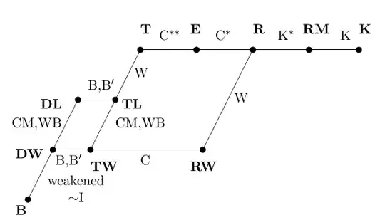

Starting with the weakest system B ("Base Logic"), we build up systems as depicted in the diagram below (from Stephen Read's Relevant Logic: A Philosophical Examination of Inference):
S. Read relevant logic systems diagram
