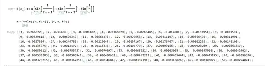

It is easy to prove that $$\frac{1}{n+1}<\frac{1}{2n+1}+\frac{1}{2n+2}<\frac1{n},\quad \forall n=1,2,3,\cdots.$$ Inspired by this inequality, I want to know the following inequalities: $$\sin\frac{1}{n+1}<\sin\frac{1}{2n+1}+\sin\frac{1}{2n+2}<\sin\frac1{n},\quad \forall n=1,2,3,\cdots.$$ What I have done now is: $$\sin\frac{1}{2n+1}+\sin\frac{1}{2n+2}-\sin\frac{1}{n+1} =\sin\frac{1}{2n+1}+\sin\frac{1}{2n+2}-2\sin\frac{1}{2n+2}\cos\frac1{2n+2}$$ $$=\sin\frac{1}{2n+1}-\sin\frac{1}{2n+2}\left(2\cos\frac1{2n+2}-1\right) >\sin\frac{1}{2n+1}-\sin\frac{1}{2n+2}>0.$$ i.e. the LHS is ture. But the same proof technique doesn't apply to the RHS. But the Wolfram mathemtica gives that it seems right for $1\leq n\leq50$, enter image description here
Any help and hints will welcome!
