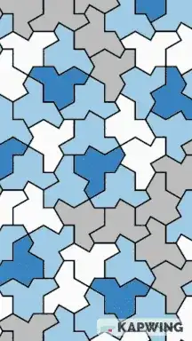

Does exist a Einstein tile analogous for covering the surface of a 3D sphere?
I Google for it and found a guy making a football (soccer) ball using a Einstein tile but he must added some other extra shape in order to make the ball, showing that a tessellation of the sphere with that shape was not possible.
example
But I didn't find some analogous shape to cover a sphere with only one aperiodic figure (here a short YT video explanation).
But neither I understand if it makes any sense to talk about aperiodic shape over a sphere since you are going to come back where you started after one turn.

@MoisheKohan the best I can do to define anything related to my questions is looking for a spherical analogue to the tiles found by David Smith.
Update 1
User @JaapScherphuis noted that in the case of a sphere talking about an aperiodic tiling make little sense since it is not infinite, and also many paths will comes back to himself. So to make sense of the question, think about an sphere of radius $0<R<\infty$, for any point on the surface of the sphere, the individual tile should be aperiodic on any geodesic that crosses this point on it is $2\pi R$ extension in all directions, an the tiles of this unique kind should cover the whole sphere surface.
User @JaapScherphuis also shared a paper in his comments where are shown some tilings with unique triangular shapes that cover the whole sphere surface, so that answers sub-question 1.
An I hope this update introduce a restriction senseful enough to make an analogous version of David Smith's tiles for the surface of the sphere (I think this also answers @MoisheKohan comment).
I think from the video you could get the intuition behind the question: any recommendations for improving the restrictions in order to make this question rigorous in the math sense are very welcomed - feel free to edit the question.
