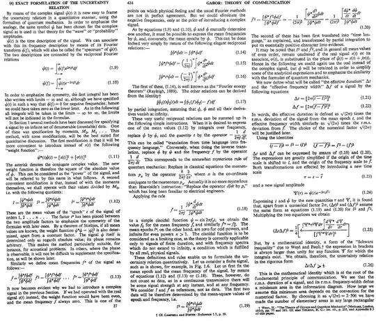

How I could evaluate Gabor's Uncertainty relation for the system of $u(x,t)$?
My initial plan was to find its Fourier Transform, then take the second moment in time and in the frequencies, and evaluate Gabor's relation, but I tried to take the bidimensional Fourier Transform but got lost on the variable integration limits. Also, I am conceptually confused about if I have to take the Bidimensional Fourier Transform, or instead only a Fourier Transform in the time variable... I would like to emulate what is done in quantum muchanics but for this classical system (if it makes sense).
Gabor's paper section I would like to reproduce
Gabor's paper
Gabor's paper could be found for free in Google as PDF file: "Theory of communication", D. Gabor (1947)
