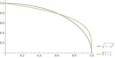

I would suggest trying the following change in the power of the exponent:
Instead of
$$\sqrt{1-x^{2}}$$
use $$(1-x)^{\frac{1}{4}}$$
Then
$$I=2\int_{0}^{x_0} e^{i \alpha (1-x)^{\frac{1}{4}}} dx,$$ The last integral can be calculated already in closed form in elementary functions.
Plot
