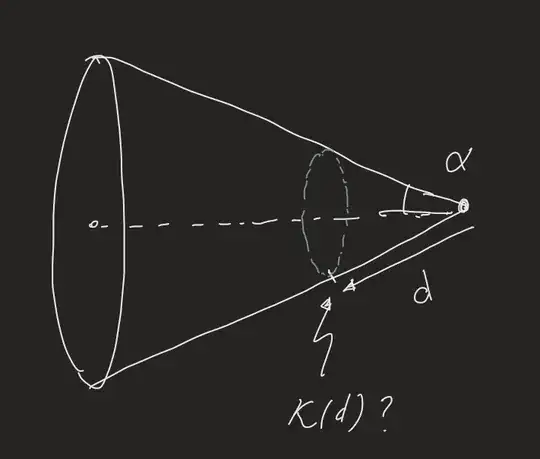

I'm trying to get the mean curvature $K/2=\kappa_1 + \kappa_2$ of a cone with a half angle $\alpha$ at a distance $d$ from the apex.
The curvature along the generator is zero $\kappa_1=0$. As for the curvature of the normal section, I'm trying to calculate it with Meusnier's theorem but I'm stuck as I don't fully understand it. I'm not sure if there's a simpler way to get it.
Here's a schematic: enter image description here

  • Here’s one way: In $xyz$-space, put the generator on the $x$-axis with the vertex at the origin and the cone lying above $xy$-plane. The bottom half of the cone is the graph of a function, $z=f(x,y)$. Find $f$. Each point on the generator is a minimum point and therefore a critical point. It follows that the Hessian of $f$ at these points is the second fundamental form. – Deane Oct 01 '24 at 03:46
    Please include a picture/diagram of this. – Nate Oct 01 '24 at 04:20

According to Meusnier's theorem, if you consider all plane sections of a surface having a common tangent, then the radius of curvature of a section is $r\cos\gamma$, where $r$ is the radius of curvature of the normal section and $\gamma$ is the angle formed with the normal section.
In your case we can take as oblique section the one perpendicular to the axis of the cone, which is a circle with radius $r=d\sin\alpha$ forming an angle $\gamma=\alpha$ with the normal section. Hence the radius of curvature of the normal section is $$ r_N={r\over\cos\alpha}=d\tan\alpha. $$
