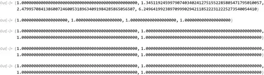

As always, the code snippet below verifies the result $(2b)$ by comparing them with the generic result, that we managed to guess for $p\ge -3$. Here we go:

res2/res1 res2a/res1 res2b/res1 res3/res1
The consecutive steps in the derivation of the negative spectral moments for <span class=$N=$." />
In view of all this my question is two fold. First of all have those results been derived before, if yes then please provide some reference from the literature. My second question would be how would one derive the results for higher values of $N$.
