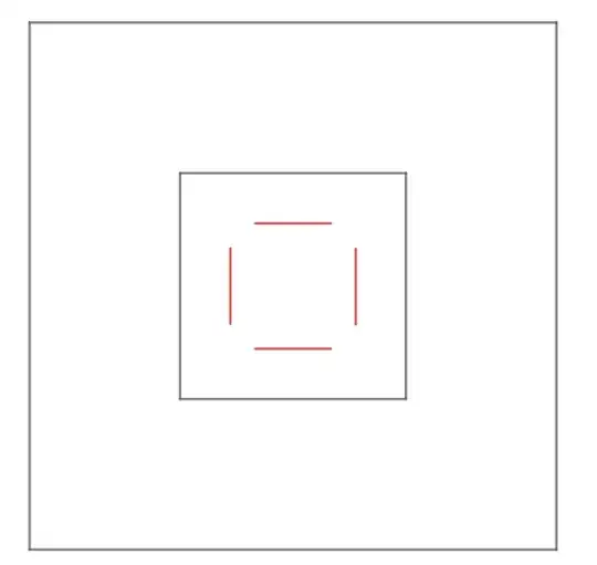

The way i decided to approach this question is by tracking the center of the cardboard. I figured that the center cannot be outside of the red lines, which are 2/3 from the sides of the 30cm by 30cm:
red lines
However, i don't know how the corners of the red square-ich area looks like. After some calculations, I figured that it has to be convex. Anybody has an idea for how to finish the solution, or has an entirely different one?

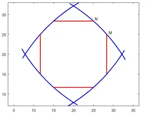

Here are the connecting arcs between your 4 (red) line segments :
Fig. 1 : "Your" line segments (in red) are connected by arcs of hyperbolas. They have been extended in order to understand them in a better way (otherwise, one could think that for example arc $MN$ is a linear segment). Point $M$ has coordinates $(85/3 ; 25)$.

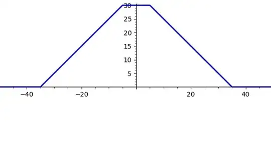

Instead of considering at once "squares' overlap", let us consider the simpler case of "strips' overlap" : being given two strips of paper with the same width, say $L$ (the value of $L$ is unimportant) ; in the middle of the first, resp. second, strip, a $L' \times 40$, resp. $L'\times 30$ rectangular window is cutted ($L'<L$). If we slide one of the strips along the other, consider the variable amount of light passing through the intersection. Let us call $f$ this function ; its graphical representation is given on fig. 2.*
Fig. 2 : Function $f$ as described above. Its different parts have equations $f(x)=0, \ \ f(x)=35 \pm x, \ \ f(x)=30$.
Remark : (can be skipped in a first reading) $f$ is in fact the convolution of 2 constant functions with resp. support length $40$ and $30$.

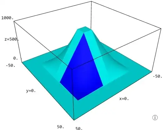

As a consequence (see legend of Fig. 2), the area of the intersection rectangle $R$ is $z=f(x)f(y)$, represented on Fig. 3 as a surface looking like a Maya pyramid... with :
  • a summital square at "altitude" $900 = 30 \times 30$ ; indeed, the different points of this square correspond to the positions of the center $(x,y)$ of the small square $S$ when it is fully included into the big square $B$,
  • $4$ planar "ramps" (planes with equations $z=35 \pm x$ or $z=35 \pm y$, and
  • $4$ skew surfaces. One of them (deep blue color) is a quadric surface with equation $z=(35-x)(35-y)$, due to the fact that $f(x)=35-x$ for $5 \le x \le 35$.
As a consequence, the upper-left level curve will be obtained by writing :
$$(35-x)(35-y)=800 \ \ \iff \ \ y=35-\frac{800}{35-x}$$
which is the equation of the top right hyperbola in Fig. 1.
Fig. 3 : Graphical representation of $z=f(x)f(y)$ where $z$ is the value of the surface of the common rectangle of the two squares when the center of the small square is positionned in $(x,y)$.

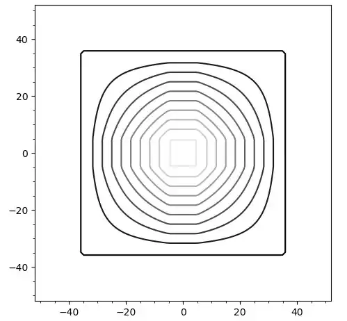

Fig. 4 : "Level lines" of the surface represented in Fig. 3. Level line $z=800$ (the smallest one, just surrounding the "summital square" at $z=900$) is the one which is represented on Fig. 1.

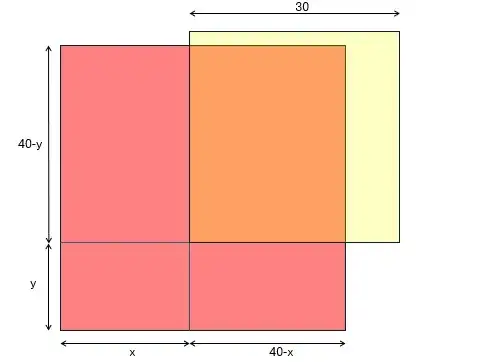

Adding the 3 red rectangular areas of Fig. 2, one gets :
$$A_{x,y}:=x(40-y)+y(40-x)+xy\tag{1}$$
Saying that the orange common area is at least $800 = 40 \times 40/2$ is equivalent to say that
$$A_{x,y} \le 800 \ \iff \ 40(x+y)-xy \le 800$$
The boundary curve has therefore the following equation:
$$40(x+y)-xy = 800 \ \iff \ y=40 \frac{20-x}{40-x}\tag{2}$$
which is the equation of a hyperbola (to be considered in a certain range of values of $x$, therefore giving only an arc of hyperbola).
