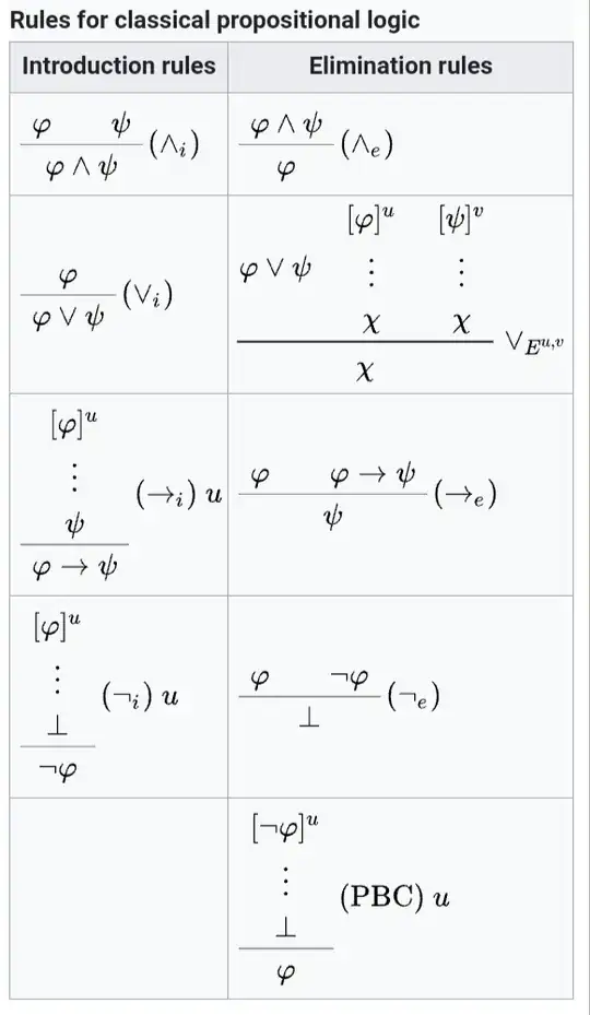

Consider the following table from Wikipedia (later I shall replace it with a MathJax one). We see three inference rules (implication introduction, negation introduction, and proof by contradiction) that discharge hypotheses:
Natural deduction propositional rules
The line with the label 'u' on its left (because the proof might employ more than one hypothesis) separates the categorical part from the hypothetical, signalling that the part below the line has a hypothesis is at work; it's the author's choice.
In the text, the judgement 'A true' is the hypothesis and the line as explained. As for the substitution of $\mathcal{D}$, a "hasty" analogy can be drawn for the sake of quick explanation to the following case:
