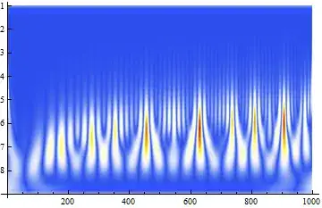

As an example: We have a vector with length 1001 and then compress it using the Mexican Hat Wavelet. As a result we get the following power spectrum plot:
Plot

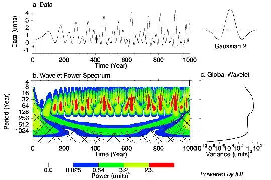

Then using this tool we obtain the same power spectrum, but with the COI added (cross-hatched region on plot $b$). Plot2
The question is how can I ... describe the COI so I can easily add it to my plots given the e-folding time for the Mexican Hat Wavelet which is $\sqrt{2}s$. In other words: Are there any equations/inequalities that model the COI ?
