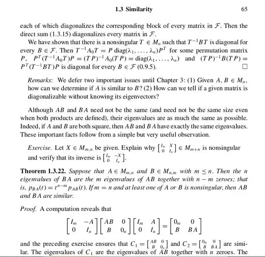

Just something I dimly remember: here is an example. Note how the characteristic polynomial for the 3 by 3 matrix $n = a^Tb,$ is precisely $x$ times the characteristic polynomial for the 2 by 2 matrix $m = a b^T.$ Found it, Horn and Johnson, Matrix Analysis, Theorem 1.3.20 on page 53. Oh, in the second edition, it is 1.3.22 on page 65. There is a discussion and proof at Do matrices $ AB $ and $ BA $ have the same minimal and characteristic polynomials? linked in comment below by Branimir Cocic

A proof of the underlying general fact (if $a$ is $m \times n$ and $b$ is $n \times m$, then $x^n\det(xI_m-ab) = x^m\det(xI_n-ba)$) can be found here. – Branimir Ćaćić Jul 29 '24 at 20:19
