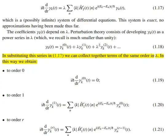

For completeness I wanted to post an excerpt here from Grynberg's Introduction to Quantum Optics which I though also answers the questions a bit more formally in terms of mathematics;
The series expansion, known as the Dyson series, is formally correct. However, to prove that it actually converges can be a major problem.
