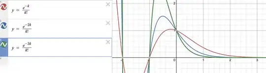

  • Wiki Digamma
    Digamma is useful, $y = \frac{e^{-kt}}{k!}$ for t = 0, 1, 2, 3 etc also looks like Digamma. It is a nice coefficient going from 100% to 0% to slow down the $e^{-e^{-c}}$ going from 0% to 100% for c = 0, 1, 2, 3 etc

Now the calculation of $e^{-e^{-1}} = 0.6922 = 69.22$% and $e^{-e^{-2}} = 0.8734 = 87.34$%
and $e^{-e^{-3}} = 0.9514 = 95.14$%
The formula states $e^{-e^{-c}} = Pr(0)$ for c=0, 1, 2, 3 ... gives the Pr(0) for desired c limit.
For the kth probability we get a simple Poisson Distribution
Pr(N = k) = $\frac{e^{-kc}}{k!} Pr(0) = \frac{e^{-kc}}{k!}e^{-e^{-c}}$
How the coefficient affects Pr(0) Probability Graph
Using this we can calculate all the moments required such as Expectation and Variance for selecting 1 coupon per round for 2 coupons total.
