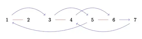

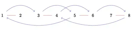

Actually we can give a straightforward uniform argument that $\Gamma \cong PSL_2(\mathbb{Z})$, and hence $SL_2(\mathbb{Z})$, has a subgroup of index $n$ for every positive integer $n$. The sequence of counts of such subgroups is A005133 on the OEIS, and the sequence of counts of conjugacy classes of subgroups is A121350 on the OEIS.
Since $\Gamma \cong C_2 \ast C_3$, the problem is equivalent to writing down a permutation $a$ of order $2$ and a permutation $b$ of order $3$ which generate a group acting transitively on a set of size $n$ (and note that in this approach it is not necessary to know anything about what group this is). These can be visualized concretely in terms of their Schreier graphs, which are graphs on $n$ vertices containing two types of edges, namely
  • undirected edges describing the action of $a$ (which switches the two vertices any $a$-edges connect), and
  • directed $3$-cycles of edges describing the action of $b$ (which cyclically permute the three vertices these $b$-cycles connect).
The resulting group action is transitive iff this graph is connected, and the only rule for how to construct them is that each vertex can be connected to at most one $a$-edge and contained in at most one $b$-cycle. Now it's not hard to construct such a graph for every $n$ by induction on $n$, possibly with a little casework depending on the value of $n \bmod 3$ or at worst $n \bmod 6$. Here are some explicit examples of permutations for $n = 7, 8$:
  • For $n = 7$ we can take $a = (12)(34)(56), b = (135)(467)$.
  • For $n = 8$ we can take $a = (12)(34)(56)(78), b = (135)(468)$.
And here are pictures of their Schreier graphs, drawn in quiver, with $a$-edges in red and $b$-cycles in blue:
For more discussion of this see my blog posts Finite index subgroups of the modular group and Drawing subgroups of the modular group. The first post also explains how to write down a generating function counting the number of subgroups of index $n$, while the second presents a Poincare dual visualization of the subgroups coming from some version of Bass-Serre theory, or some version of the theory of dessins, which even lets you read off a presentation of the subgroup. The idea is to think of $B \Gamma$ as a wedge sum of $B C_2$ and $B C_3$ and to try to visualize its covering spaces as such wedge sums.
