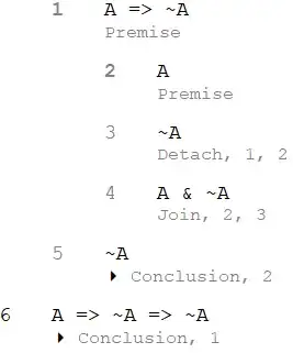

As you requested...
Screenshot:
Note: Consistent with other infix binary operators in the system used here, '=>' is left-associative.
Text version:
1   A => ~A
    Premise
2   A
    Premise
3   ~A
    Detach, 1, 2
4   A & ~A
    Join, 2, 3
5 ~A Conclusion, 2
6 A => ~A => ~A Conclusion, 1
