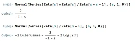

Series expansions in Mathematica 14:

    Limit[Zeta[s]*Zeta[s]/Zeta[s + s - 1] + Zeta[s]/Zeta[s - 1], s -> 1] == -2 EulerGamma + 2 Log[2 \[Pi]] – Mats Granvik Jul 21 '24 at 12:56

    Normal[Series[Zeta[s]*Zeta[s]/Zeta[s + s - 1], {s, 1, 0}]] Series1 Normal[Series[Zeta[s]/Zeta[s - 1], {s, 1, 0}]] Series2 – Mats Granvik Aug 22 '24 at 12:10
