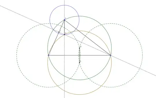

In figure O is circumcenter and K is its reflection over BC.Since we have coordinates of vertices we can calculate length of the sides a, b and c and also R the radius of circum circle.We use the fact that the circle passing two vertices and orthicenter H has the equal radius as circumcircle.The coordinates of O and K is the solution of the following system of equations:
$\begin{cases}(X_B-Y_O)^2+(Y_B-Y_O)^2=R^2\\(X_C-X_O)^2+(Y_C-Y_O)^2=R^2\end{cases}$
Now we use this fact that $AH=OK=R_1$. So the coordinates of H is the solution of the following system of equations:
$\begin{cases}(X_K-X_H)^2+(Y_K-Y_H)^2=R^2\\(X_A-X_H)^2+(Y_A-Y_H)^2=R_1^2\end{cases}$
