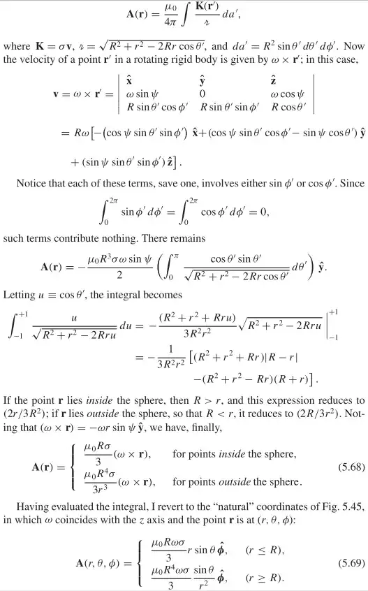

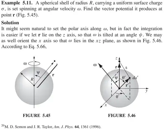

On the other hand, I check the answer (from INTRODUCTION TO ELECTRODYNAMICS, fourth edition, David J. Griffiths) of this exercise, which is given below. However, I still prefer finding a way of directly calculating $$\int_{0}^{2\pi}\int_{0}^{\pi}\frac{(z_0-R\cos\theta)\sin^2\theta\cos\phi}{[(x_0-R\cos\phi\sin\theta)^2+(y_0-R\sin\phi\sin\theta)^2+(z_0-R\cos\theta)^2]^{\frac{3}{2}}}d\theta d\phi$$ instead of using the vector potential. Any help will be appreciated.
