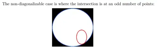

I try to relate this exercise to a proposition in the PDF:
The non-diagonalizable case is where the intersection is at an odd number of points: enter image description here
The two conics $$x^2+y^2-z^2=0, \quad x^2+y^2-y z=0$$ intersect at two points $[1,\pm i,0]$ with multiplicity $1$, and one point $[0,1,1]$ with multiplicity $2$. So the intersection is at an odd number of points, so they cannot be simultaneously diagonalized.
But how do we prove this proposition?
