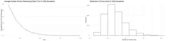

I know I can run multiple simulations of different game and see how many turns for each game to end, and the number of coins remaining at each turn for each game:
But can these types of questions be answered theoretically?
