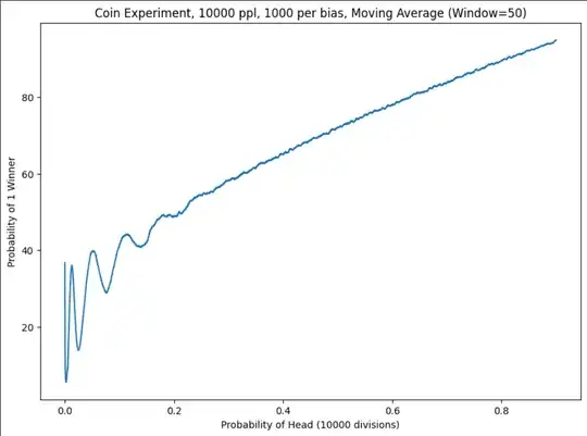

Then, I ran an experiment by writing a program with the following parameters:
  1. Bias of the coin: 0.0001 - 0.8999 (8999 values)
  2. Number of people: 10000
  3. Number of times experiment run per Bias: 1000
I plotted the Probability of 1 Winner vs Bias
The plot was interesting with zig-zag for low bias (for heads) and a smooth one after p = 0.2. (Also, there is a 73% chance of a single winner for a fair coin).
Is there an analytic expression for the function $$f(p) = (\textrm{probability of $1$ winner with a coin of bias $p$}) \textbf{?}$$

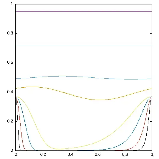

There is a pretty simple formula for the probability of a unique winner, although it involves an infinite sum. To derive the formula, suppose that there are $n$ people, and that you continue tossing until everyone is out, since they all got tails. Then you want the probability that at the last time before everyone was out, there was just one person left. If $p$ is the probability that the coin-flip is heads, to find the probability that this happens after $k+1$ steps with just person $i$ left, you can multiply the probability that person $i$ survives for $k$ steps, which is $p^k$, by the probability that he is out on the $k+1^{\rm st}$ step, which is $1-p$. You also have to multiply this by the probability that none of the other $n-1$ people survive for $k$ steps, which is $1-p^k$ for each of them. Multiplying these probabilities together gives $$ p^k (1-p) (1-p^k)^{n-1} $$ and summing over the $n$ possible choices for $i$ and all $k$ gives $$ f(p)= (1-p)\sum_{k\ge 1} n p^k (1 - p^k)^{n-1}.\qquad\qquad(*) $$ (I am assuming that $n>1$, so $k=0$ is impossible.)
Now, the summand in (*) can be approximated by $n p^k \exp(-n p^k)$, so if $n=p^{-L-\epsilon}$, $L\ge 0$ large and integral, $0\le \epsilon \le1$, $f(p)$ will be about $$ (1-p) \sum_{j\ge 1-L} p^{j-\epsilon} \exp(-p^{j-\epsilon}) $$ and we can further approximate this by summing over all integers: if $L$ becomes large and $\epsilon$ approaches some $0\le \delta \le 1$, $f(p)$ will approach $$ g(\delta):=(1-p)\sum_{j\in\Bbb Z} p^{j-\delta} \exp(-p^{j-\delta}). $$ The average of this over $\delta$ has the simple formula $$ \int_0^1 g(\delta) d\delta = (1-p)\int_{\Bbb R} p^x \exp(-p^x) dx = -\frac{1-p}{\log p}, $$ which is $1/(2 \log 2)\approx 0.72134752$ if $p=\frac 1 2$, but as others have pointed out, $g(\delta)$ oscillates, so the large-$n$ limit for $f(p)$ will not exist. You can expand $g$ in Fourier series to get $$ g(\delta)=-\frac{1-p}{\log p}\left(1+2\sum_{n\ge 1} \Re\left(e^{2\pi i n \delta} \,\,\Gamma(1 + \frac{2\pi i n}{\log p})\right) \right). $$ Since $\Gamma(1+ri)$ falls off exponentially as $|r|$ becomes large, the peak-to-peak amplitude of the largest oscillation will be $$ h(p):=-\frac{4(1-p)}{\log p} \left|\Gamma(1+\frac{2\pi i}{\log p})\right|, $$ which, as has already been pointed out, is $\approx 1.426\cdot 10^{-5}$ for $p=1/2$. For some smaller $p$ it will be larger, although for very small $p$, it will decrease as the value of the gamma function approaches 1 and $|\log p|$ increases. This doesn't mean that the overall oscillation disappears, though, since other terms in the Fourier series will become significant. To illustrate this, here are some graphs of $g(\delta)$. From top to bottom, the $p$ values are $0.9$, $0.5$, $0.2$, $0.1$, $10^{-3}$, $10^{-6}$, $10^{-12}$, and $10^{-24}$. As $p$ becomes small, $$ g(0)=(1-p)\sum_{j\in\Bbb Z} p^{j} \exp(-p^{j}) \ \ \qquad {\rm approaches} \ \ \qquad p^0 \exp(-p^0) = \frac 1 e. $$
Graphs of g(delta)
References
David Moews
  • 17,341

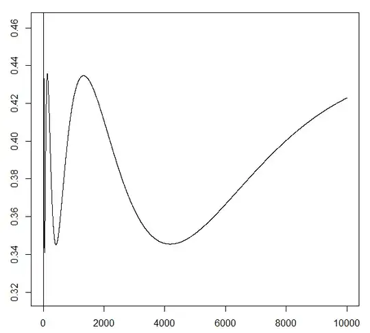

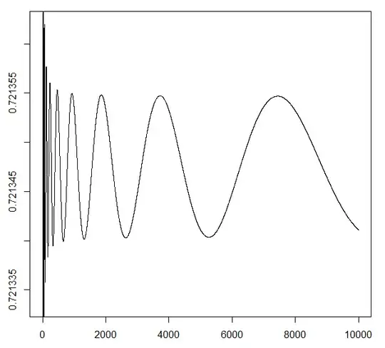

An extended comment:
I doubt there is an analytic expression, though there will be a recursion for a finite number of starting players. I also suspect there may not be a limit for a given probability of heads as the number of starting players increases.
Here are the probabilities for up to $10000$ starting players when using a fair coin $(p=0.5)$. The rounded probabilities for ending up with a single remaining player are close to $0.72135$ but the chart is not persuasive that there is a single limit.
I suspect your zig-zag observations result from this fluctuation: $10000$ starters may be close to the top of the curve for some probabilities of heads and close to the bottom for nearby probabilities of heads.
drawn with R:
pheads <- 0.5
maxn <- 10000
pwin <- 1
for (n in 2:maxn){
  pwin[n] <- sum(dbinom(1:(n-1), n, pheads) * pwin) /(1-dbinom(n, n, pheads))
midright <- mean(pwin[(maxn/2):maxn])
rangeright <- max(pwin[(maxn/2):maxn]) - min(pwin[(maxn/2):maxn])
plot(pwin, ylim=c(midright-rangeright, midright+rangeright), type="l")
With a smaller probability of heads, say $0.1$, the range of the fluctuations is substantially wider:
Henry
  • 169,616
  • Hey, Thanks! I tried simulating it for a fixed probability and variable people and found similar plots. In the case of a fixed number of people and variable probability, it showed consistent behaviour after p=0.2; I expected it to fluctuate as well. It still begs the question of what makes it more likely for say, 4000 people to have a winner while 5000 people are less likely, and 6000 people are more likely again – Mystic Mickey May 24 '24 at 20:23
    For p=0.5, 1/p=2, and $2^{10}=1024$, $2^{11}=2048$, $2^{12}=4096$, so these values are 'high' in the first graph, and low points are $2^{9.5}$, $2^{10.5}$ etc ; for any $p$, for $n$ people at the beginning, if ln(n) / ln(p) is close to an integer k, the probability to reach 1 is high, and we should reach 1 after k steps. – Lourrran May 24 '24 at 20:30
    MysticMickey: Suppose you look at a probability of heads of $\frac1{10}$. Then with $0$ players left you lose, with $1$ player left you win, with $2$ players left you have a probability of $\frac{2}{11} \approx 0.18$ of winning. If you start with $10$ people you are quite likely to end up with $1$ player after a single round and then win; if you start with $20$ people you are quite likely to end up with $2$ players after a single round and then lose. You might see something broadly similar with $100$ and $200$ starting people but an extra round. And more generally as @Lourrran suggests. – Henry May 24 '24 at 20:37
  • Thanks @Lourrran Henry. This also explains why the probability fluctuates less as p increases! – Mystic Mickey May 24 '24 at 20:52
    These intuitions about the fluctuations seem worth including in the answer itself. – David K May 26 '24 at 15:31

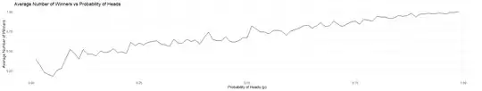

It seems like there are already great answers to this question, but I just wanted to take a shot at it.
When I watched the video clip about the coin flipping game, the first thing that came to mind was the following ideas:
  • Suppose in a game, what happens if all players get Tails on the first flip (i.e. round=1)? Does this mean that there were no winners?
  • Suppose in some other game, what if in round=5 there are 41 players left - and then in round=6, all players flip Tails? Does this also mean that there are no winners?
To me, it seems that in this coin flipping game, there might not always be a winner.
I was curious and wrote an R simulation myself.
First, I defined a function to run the coin flipping game that was described in the video:
simulate_game <- function(num_players, p_heads) {
  results <- data.frame(player = paste0("player", 1:num_players))
  status <- rep("playing", num_players)
  seen_tails <- rep(FALSE, num_players)
  round <- 1
simulation
while (sum(status == "playing") > 1) { coin_flips <- ifelse(runif(num_players) < p_heads, "heads", "tails") seen_tails <- ifelse(coin_flips == "tails", TRUE, seen_tails) current_round <- ifelse(status == "playing", coin_flips, "eliminated") status <- ifelse(seen_tails == TRUE, "eliminated", status) results <- cbind(results, current_round) colnames(results)[ncol(results)] <- paste0("round_", round) round <- round + 1 }
if only one player left playing, declare them as the winner
if (sum(status == "playing") == 1) { winner_index <- which(status == "playing") results[winner_index, ncol(results) + 1] <- "winner" results[-winner_index, ncol(results)] <- "eliminated" colnames(results)[ncol(results)] <- paste0("round_", round) }
num_winners_last_round <- sum(results[,ncol(results)] == "winner") return(num_winners_last_round) }
run_simulations <- function(num_players, num_simulations, p_values) { avg_num_winners_list <- numeric(length(p_values))
This code looks at the average number of winners in a set of games. The way I see it, an individual game can either have $1$ winner or $0$ winners. In a set of $n$ games, the average number of winners must be between $(0,1)$.
Now, I repeated this simulation for 1000 players and different values of success probabilities for the coin:
num_players <- 100
num_simulations <- 100
p_values <- seq(0.01, 0.99, by = 0.01)
final_results <- run_simulations(num_players, num_simulations, p_values)
print(final_results)
Finally, I plotted the results:
library(ggplot2)
ggplot(final_results, aes(x = p, y = avg_num_winners)) +
    geom_line() +
    labs(title = "Average Number of Winners vs Probability of Heads",
         x = "Probability of Heads (p)",
         y = "Average Number of Winners") +
    theme_minimal()
I also got a similar zig-zag shaped plot:
After doing all this work, I just realized that my answer does not really provide any anything of value to this question ... there are no mathematical derivations in my answer, and previous users have submitted similar simulations as mine that seem to be far more efficient ... but in the spirit of mathematics and curiosity, I wanted to share my ideas!
