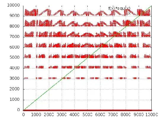

But it turns out that using the graphics is not precise enough to identify fixed points.
In the end one needs a computer programm to check all numbers $n \in \{ 0, \ldots, 9999 \}$ for a proper fixed point from $\mathbb{N}^2$.
Graph with "set samples = 10000"
Note: The $\mbox{equ}$ function was used to set the arguments with repeated digits to zero.

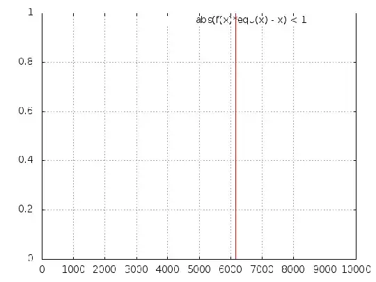

Update: This seems to work:
gnuplot> set samples 10000
gnuplot> plot [0:9999] [0:1] abs(f(x)*equ(x) - x) < 0.1
filtered plot
Note: The algebraic expressions I used made analysis not easier, the terms are too unwieldy to give the insight to determine the fixed points. It boiled down to to trying out every argument and checking the function value via a computer.
