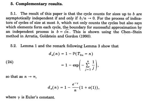

The Arratia and Tavaré paper
https://projecteuclid.org/journals/annals-of-probability/volume-20/issue-3/The-Cycle-Structure-of-Random-Permutations/10.1214/aop/1176989707.full
explains similar links in its section 5.2 (page 1586), but doesn't take it further, nor am I familiar enough with its notation to really understand what it's trying to say.
snippet of same pattern
