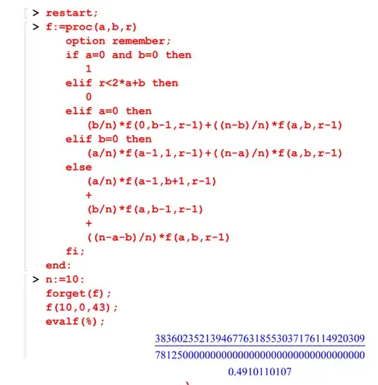

Randomly distributing $m$ cookies to $n$ children, one cookie at a time, let $f(a,b,r)$ be the probability that each child ends up with at least two cookies, assuming
  • There are $r$ cookies remaining to be distributed.$\\[4pt]$
  • There are $a$ children who have so far received no cookies.$\\[4pt]$
  • There are $b$ children who have so far received exactly one cookie.$\\[4pt]$
  • There are $n-a-b$ children who have so far received at least two cookies.$\\[4pt]$
For $m=43,n=10$, we want to find $f(10,0,43)$.
Shown below is a recursive solution, implemented in Maple.
Equivalent Python code:

@lru_cache(None) def f(a, b, r): if a == 0 and b == 0: return 1 elif r < 2 * a + b: return 0 elif a == 0: return (b / n) * f(0, b - 1, r - 1) + ((n - b) / n) * f(a, b, r - 1) elif b == 0: return (a / n) * f(a - 1, 1, r - 1) + ((n - a) / n) * f(a, b, r - 1) else: return (a / n) * f(a - 1, b + 1, r - 1) + (b / n) * f(a, b - 1, r - 1) + ((n - a - b) / n) * f(a, b, r - 1)
result = f(10, 0, 43) print(result)
