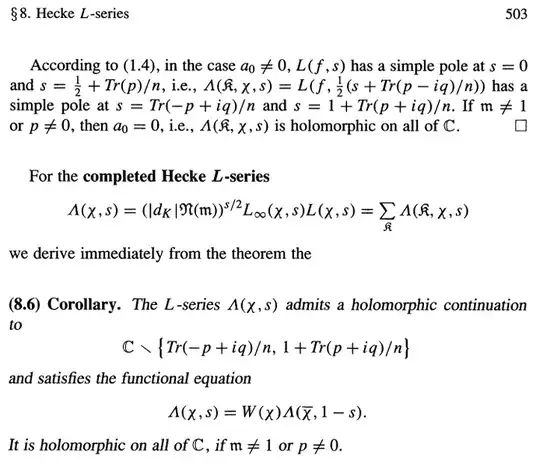

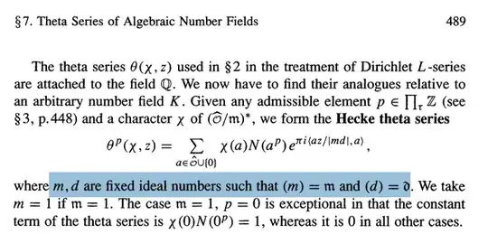

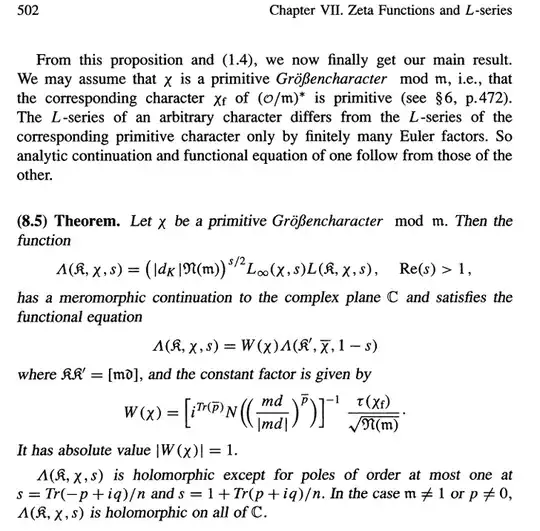

Now in Neukirch "Algebraic number theory", it is formulated by using the notion of "ideal numbers". For this notion, I want you to see this question which is perhaps useful information.
First $m,d$ be the ideal number defined by the following: pic1
Then the functional equation is stated as follows: pic2
pic3
Question1. Please show me the proof of the each formulation of Miyake and Neukirch are equivalent.
Question2. Please show me the proof of the functional equation formulated by ideal (not Tate's thesis).

  • Hmm OK, I haven't merely found the proof (Miyake's book doesn't include the proof and I don't know what is original source). I just ask you to prove these. What I have done is searching various materials including Hecke's old text book but I haven't found what I really want. Also, Miyake's $W(\chi)$ has a term of power of $2$, but Neukirch 's one seems not to have power of $2$, and I have bit anxiety for whether they are really equivalent. – user682141 May 15 '24 at 05:28
  • More, in Neukirch's proof, beautiful function the Hecke theta series appears in ideal number term (it seems to be hidden in Tate's thesis). I also hope for knowing it by ideal term. – user682141 May 15 '24 at 06:29
