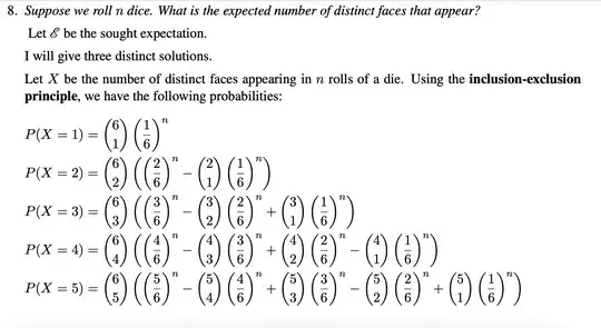

I solved this problem using linearity of expectation but am trying to understand the above solution that uses the principle of inclusion exclusion. I'm struggling to understand how it is applied in the cases where $ X \geq 2 $.
Looking at the X = 2 case for example:
It seems that $\binom{6}{2}$ is counting the number of ways to choose our 2 distinct faces.
However, I don't understand the expression in parentheses that it is multiplied by. How is PIE applied to arrive at this expression? What are the events?

    For $X=2$, you choose two values, then look at the probability that you get only those two values. But then, you must subtract off the two associated single valued cases. – lulu Apr 20 '24 at 21:05
    For $X=3$, you first subtract off the $3=\binom 32$ two valued subcases then, noticing that you subtracted each single valued subcase twice, you must add one copy of each back in. And so on. – lulu Apr 20 '24 at 21:12
Easiest approach is to explain the computation for $~P(X=5).~$ Once you understand this, the other computations will fall into place.
First, there are $~\displaystyle \binom{6}{5}~$ ways of determining which $~5~$ faces will appear. This explains the first factor. So, now you can assume that the problem has been reduced to determining the probability that the faces represented by the elements in $~\{1,2,3,4,5\},~$ appear, and the face represented by the element $~\{6\}~$ does not appear.
Here, I will express the probability as
$$\frac{N}{D} ~: ~D = 6^n ~: n \in \Bbb{Z_{\geq 5}}.$$
First, see this article for an introduction to Inclusion-Exclusion. Then, see this answer for an explanation of and justification for the Inclusion-Exclusion formula.
I will follow the syntax in the 2nd linked article above.
Let $~S~$ denote the set of all possible rolls of $~n~$ dice, where the number $~6~$ never appears. Note that some of the elements in $~S~$ represent $~n~$ dice rolls where (for example) the number $~1~$ also does not appear.
For $~k \in \{1,2,3,4,5\},~$ let $~S_k~$ denote the subset of $~S~$ such that the dice roll $~k~$ never appears. Note that in the subset $~S_k~$ there will be elements where some of the other dice roll numbers also do not appear.
Then, the desired computation for $~N~$ is represented by
$$|~S~| - |~S_1 \cup S_2 \cup \cdots \cup S_5~|. \tag1 $$
Let $~T_0~$ denote $~|~S~|.~$
This implies that $~T_0 = 5^n.~$
Let $~T_1~$ denote $~|~S_1~| + |~S_2~| + \cdots + |~S_5~|.~$
By considerations of symmetry,
This implies that $~\displaystyle T_1 = \binom{5}{1} \times 4^n.~$
For $~r \in \{2,3,4,5\},~$ let $~T_r~$ denote
$\displaystyle \sum_{1 \leq i_1 < i_2 < \cdots < i_r \leq 5} |~S_{i_1} \cap S_{i_2} \cap \cdots \cap S_{i_r}~|.$
That is, $~T_r~$ denotes the summation of $~\displaystyle \binom{5}{r}~$ terms.
$$T_r = \binom{5}{r} (5-r)^n. \tag2 $$
Clarification
$T_5 = 0,~$ which corresponds to the fact that $~S_1 \cap \cdots \cap S_5~$ is the empty set. That is, when you have $~n~$ dice rolls, you must have more than $~0~$ numbers appearing.
Clarification
The formula given in (2) above also applies to the computation for $~T_0~$ and $~T_1.$
By Inclusion-Exclusion theory, the computation expressed in (1) above is equivalent to
$$\sum_{r=0}^5 (-1)^r T_r$$
$$= \sum_{r=0}^5 (-1)^r \left[ ~\binom{5}{r} (5-r)^n ~\right].$$
This is consistent with the formula for $~p(X = 5),~$ given in the posted question.
