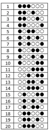

All (20) possible sequences made from 3 black + 3 white balls:

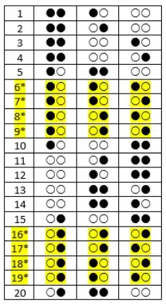

Partitioned into 3 bins:

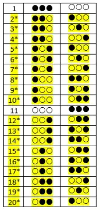

Partitioned into 2 bins:
