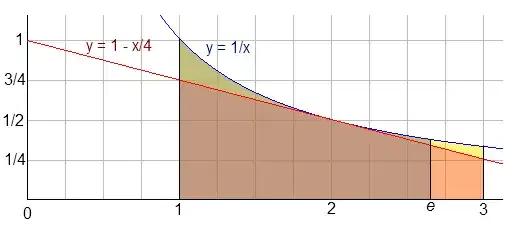

Another way of showing that $e<3$, using $ \int_1^e \frac{1}{x} dx = 1$ (similar to the answer by dfeuer)
For any $x>0$ we have :
$$0\le (x-2)^2 = x^2-4x + 4 \implies \frac{1}{x} \ge 1-\frac{x}{4} \tag{1}$$
Then we can bound the integral by the area below the line: $$\int_1^3 \frac{1}{x} \, dx \ge \int_1^3 \left(1 - \frac{x}{4}\right) \, dx = 2 \frac{3/4 + 1/4}{2} =1 \tag{2}$$
This implies that $e \le 3$ (further, the inequality can be made strict by noting that $(1)$ is strict except for the single point $x=2$)
That $\pi >3$ can be seen easily by bounding the circle perimeter with an inscribed hexagon.
