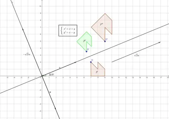

To help you, I'll give you an example to illustrate the link with elementary geometry. As you have done, I am happy to place myself in a two-dimensional vector space, moreover on the field of real numbers, in this case simply the plane $\mathbb R^2$.And I consider the canonical basis $\{e:=(1,0),f:=(0,1)\}$ and a linear map $$a:\mathbb R^2\to \mathbb R^2$$ $$(x,y)\mapsto(x+y,x-y)$$
Matrix of $a$ in basis $\{e:=(1,0),f:=(0,1)\}$ is $$A=\begin{bmatrix}1 & 1 \\1 & -1\end{bmatrix}$$Without going into the details of the explanation of why, $a$ is the orthogonal symmetry that you can see on the illustration composed with the homothety of ratio $\sqrt2$enter image description here For example $$D=(7,2)\to (7-2,7+2)=(5,9)=D'$$ We're going to find that again with the calculations $$det(A-\lambda I)=\begin{vmatrix}1-\lambda & 1 \\1 & -1-\lambda\end{vmatrix}=(\lambda-\sqrt{2})(\lambda+\sqrt{2})$$
The eigenvalues are then $\sqrt2$ and $-\sqrt2$.
$$a((x,y))=\sqrt2(x,y)\iff \begin{cases} x+y=\sqrt2x\\ x-y=\sqrt2y \end{cases}$$ $$\iff x(1-\sqrt2)+y=0$$ I've chosen as my associated eigenvector $u=5(1,\sqrt2-1)$
Likewise, $w=5(\sqrt2-1,-1)$
Everything is interpreted geometrically. If you think about this geometric interpretation, you understand. Otherwise, you don't understand anything.
Note that
  • in basis $\{u,v\}$, Matrix of $a$ is $$\begin{bmatrix}\sqrt{2} & 0\\0 & -\sqrt{2}\end{bmatrix}$$
  • We calculate $det(A-\lambda I)$ since $$\exists \vec x\neq 0, a(\vec x)=\lambda \vec x\iff (a-\lambda id)(\vec x)=0$$$$\iff a-\lambda id \text{ is not injective}$$ $$\iff a-\lambda id \text{ is not bijective }\iff det (a-\lambda id)=0$$ $$\iff det(A-\lambda I)=0$$
  • Interesting answer thanks for putting the effort into creating this. Regarding the mapping of $(x, y)\to(x+y, x-y)$ why is this mapping there and what is it's purpose? I don't understand the connection to the rest of the question. – user3728501 Apr 07 '24 at 18:11
  • I find this type of example very useful and necessary before getting into the mathematical technicalities. As I conclude, it seems illusory to me to try to understand what eigenvectors and eigenvalues are before having such examples from elementary geometry – Stéphane Jaouen Apr 07 '24 at 18:13
  • To learn mathematics, we take examples. We start with the particular and generalize little by little. Then possibly only after from the general to the particular. But always first of all from the particular to the general. Not the other way around. I took an example in dimension $2$. OP had a good idea with dimension $1$ first. – Stéphane Jaouen Apr 07 '24 at 18:28
