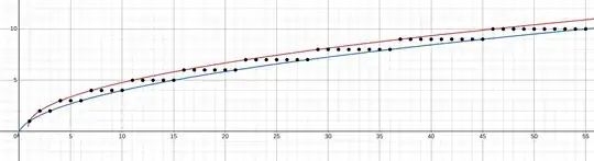

The following questions arise out of just curiosity. On a graph, this function looks like many things. My first guess was that it was some sort of logarithm (idea later revised), but my immediate question was: for domain $[1, p]$, what logarithm base, denoted $b$, would provide the best approximation? Around $2$? My second question is: would a better approximation be a parabola/hyperbola. The sequence slows down very quickly, so instead of a parabola, could it be some sort of flipped $x^6$ or higher even power?

Since $k \sim n^2$, this inverted function is on the order $n \sim k^{1/2}$, as expected. This formula also gives nice bounds for the $n$th term that are half parabolas opening to the right: $$ \frac{-1 + \sqrt{8k + 1}}{2} \leq f(k) \leq \frac{1 + \sqrt{8k - 7}}{2} $$
Sequence with bounding curves.
