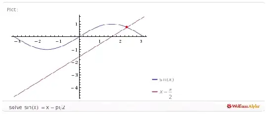

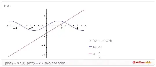

You can rewrite the expression as $$\sin(a) =a - \frac{\pi}{2}$$ so that each side of the equality is a function of $a$, each of which can be graphed (on the same graph!).
The LHS can be graphed as $$f(a) = \sin(a)$$ the graph of which you should know well,
and the RHS can be graphed as $$g(a) = a - \frac{\pi}{2}$$ Clearly, the graph of $g(a)$ is simply a line, with y-intercept $\left(-\frac {\pi}{2}, 0\right)$ and slope $= 1$.
You can use your graphs, then, to approximate any potential solutions; that is, find any point(s) of intersection. From that, you can probably "trouble shoot" with your calculator to make this approximation more precise.
I'll include graphs below:

  • Was hoping for an algebraic solution, but this will do as a fall back. Thanks! – Michael Dorgan Jul 01 '11 at 17:47
  • Sometimes just having an estimated solution helps you then construct an algorithm, if it is possible to do so, since you then have your "starting point", and an approximate "ending point" to work with. Also, simply having a visual representation of what's "going on" with a given expression is helpful. – amWhy Jul 01 '11 at 17:54
  • Agreed. I'll give you your cookie then :) – Michael Dorgan Jul 01 '11 at 17:57
  • The solution is given by $a = \frac{\pi}{2} - D$ where $D$ is the Dottie Number. See my comments to this question. If you agree that this is a dupe, please cast your vote. This is the third such question... (see Mark's comment for the second one). – Aryabhata Jul 01 '11 at 18:29
  • Guys, the algrebra is wrong here, it should be a - π/2, the signs are backwards in this answer. – Michael Dorgan Jul 01 '11 at 18:37
  • @MIcheal: Yes, it is $a = \pi/2 + D$. Did you look at the links I gave you? – Aryabhata Jul 01 '11 at 18:46
