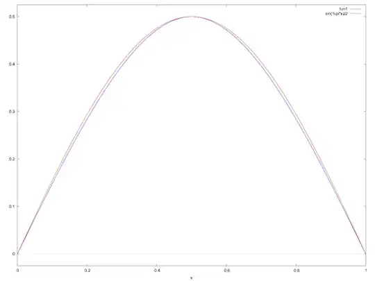

Equality holds if $a=f'(1/2) = 0$ and $f''(x) = \text{const} \cdot x$ on $[0, 1/2]$ and $f''(x) = \text{const} \cdot (1-x)$ on $[1/2, 1]$, that leads to $$ f(x) = \begin{cases} -2 x^3 + \frac 3 2 x & \text{ for } 0 \le x \le \frac 12 \, , \\ 2 x^3 -6 x^2 + \frac 92 x -1/2 & \text{ for } \frac 12 \le x \le 1 \, . \end{cases} $$
The following graph (created with wxMaxima) shows that function (blue) and, for comparison, the function $\sin(\pi x)/2$ (red).
