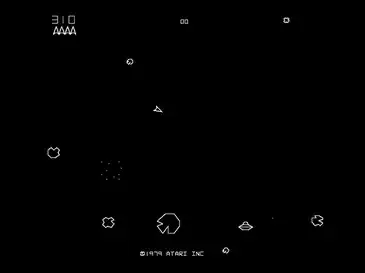

Video games often have a toroidal geometry, in which that game space is a rectangle where going off one edge returns one to the opposite edge:
Screengrab of Atari "Asteroids" space
so one might ask whether the little spaceship in the game can see the “hole” in the donut. And the answer is that while the surface of a donut can model such a space, you don't need the donut, all you need is the rectangle with the connected edges. In this model of the torus, there is literally no hole anywhere to be found.

The old Asteroids game from the early days of arcade video games is a good example.
The asteroids in this game traveled at constant velocity through a two-dimensional toroidal space. That is, when an asteroid went off the bottom of the screen it reappeared at the top, and when it went off the right edge it reappeared on the left edge. In each case it reappeared with the exact same speed and direction.
We call the space in which the Asteroids game lives "toroidal" because one way to visualize its topology is to imagine that we put a photograph of the game screen on a rubber sheet and glue the left edge to the right edge to form a cylinder. That lets objects cross the left or right edge of the screen and come back in on the opposite edge. Then we can bend this cylinder into the shape of a torus to connect the top edge of the screen to the bottom edge.
But now a velocity that was constant in the game is no longer constant in the 3-space in which the torus is embedded, because we had to stretch or compress the rubber sheet in order to bend it into the shape of a torus.
Even worse, we could just as well have glued the top edge to the bottom edge to make a cylinder that way and then glued the left to the right. The difference between these embeddings is that in one case, you can encircle the "hole" of the "donut" by traveling up the middle of the screen from bottom to top, but traveling from left to right makes a circle that doesn't go around the "hole"; whereas in the other case you encircle the "hole" of the "donut" by traveling across the screen from left to right, but going bottom to top makes a circle that doesn't go around the "hole".
