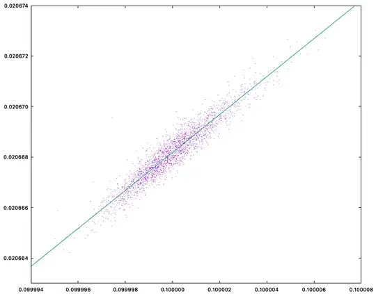

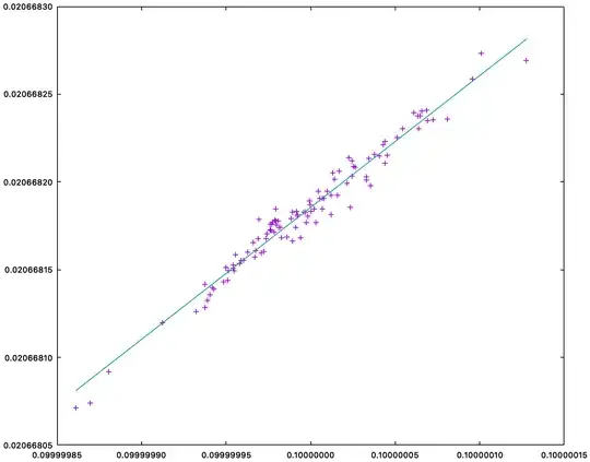

In the present setup, we’re not taking independent samples of $X$, but the situation is similar in that if we rotate the quadrature grids in a way that makes $X$ come out too high, $X^2$ will probably also come out too high. Here are plots of the quadrature result for $X$ versus $X^2$. The first plot is with lots of results on a smaller grid (of order $53$ with $974$ points), and the second one with fewer results on the full $5810$-point grid. (Each of the latter runs has to evaluate $5810^3\approx2\cdot10^{11}$ triangles, so I only did $108$ of those.)
scatter plot for smaller grid
scatter plot for larger grid
The slope of the regression line is about $0.7$, so the effect is considerably stronger than in the purely random case (where it would have been $2\langle X\rangle=0.2$). Substracting out the fitted linear function reduces the sample standard deviation from $1.2\cdot10^{-6}$ to $3.7\cdot10^{-7}$ for the smaller grid and from $3.6\cdot10^{-8}$ to $6.4\cdot10^{-9}$ for the larger grid, so we gain almost a full significant digit by making use of the known exact value of $\langle X\rangle$. The result for the larger grid is
